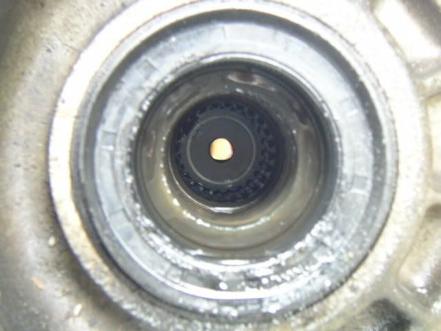

i ripped out my engine and gearbox yesterday and looking down where the drive shafts go i dont see the usual bar that one would expect to see with an e58 box from a gtz levin. instead i see this,
i know its an lsd because i dont get single spinner action when im accelerating quite quickly or in the wet

Postby Mr Revhead » Fri Nov 16, 2007 10:19 am
what happens when you try and turn one wheel only?
Postby gasman » Fri Nov 16, 2007 11:27 am
i think it turns the same way from memory

Postby Mr Revhead » Fri Nov 16, 2007 11:29 am
then my bet is on an aftermarket LSD
Postby IH8TEC » Fri Nov 16, 2007 12:11 pm
if that hole is about 6-8mm it will be an aftermarket one, most likely plate lsd. mine and bazz's are trd units, with same size hole, possibly a kaaz, or even cusco. a non lsd will have about a 20mm hole,. and a viscous one will have a hex bar

Postby AceSniper » Fri Nov 16, 2007 1:13 pm
wouldnt bother pulling it apart unless you want to recon it, Or know what your doing... Also all the ones I have seen dont have any names or anything stamped on them... Its a matter of identifying the housing.
Also with the E series wont the axels tell you if its a stock or aftermarket lsd since the lsd axels differ?

Postby IH8TEC » Fri Nov 16, 2007 4:38 pm
no, unless it originally had a viscous lsd. i'm using my non-lsd shafts with my trd lsd. the viscous input shaft is slight longer on the umm, passenger side i think, to drive it
Postby flygt4 » Fri Nov 16, 2007 5:03 pm
does it clunk and groan on tight turns?
does it skip a wheel on tight turns?
both are good signs of a mechanical lsd.

Postby gasman » Fri Nov 16, 2007 5:10 pm
yea thats exactely what it does. moans and stuf when turning. i always thought it was the cvs but it wasnt "tickey" enough to be them
