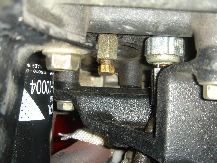

I want to hook up a Oil Pressure gauge, but dont want to loose the factory light / and am told ECU engine shutdown on low pressure (true ?)
Here is a pic of below the car looking up. Is the sender with 5N on it the pressure sender ? (assume yes)
What about the unused/plugged hole to the left of it ?
If it has a factory Oil Pressure sender, can I simply get an Oil Pressure gauge that can also use this same sender ?

that plugged hole is the block water drain.
yes the sender with 5n on it is the switch for the dash light,
the ecu wont shut the car down for low oil pressure.
if you buy a brass T you can run both off the same pressure port,
or else just run the guage, as with a guage you wont need the dash light.
