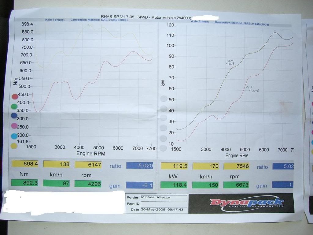

Here is previous dyno sheets.
Stock standard with pod filter only (power run @ Tricky Tune) -
HKS Super Header type II, 2.5" exhaust with 1x reso and a twin loop muffler, Pod filter, Apexi Power FC. Tuned by Speedfactor tauranga -

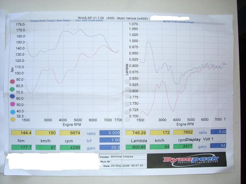

*EDIT* Dyno plots are stock Power FC map and tuned map.
Exact same mods as above, driven for a few months.

Well after driving around my car for a while, i wanted to get it check tuned.
There was a massive flat spot below 2500rpm (as you can see on the Super Rich fuelling on the old Dyno sheet) and the throttle response was overly poor.
I took into another tuner, and they tried to patch up the old tune.
They said it was pretty messy, so i decided to go for a FULL RETUNE.
This resulted in about 20-30kw increase of power over the full midrange, with about 10kw up top.
Torque @ 4000rpm almost doubled...
It was about 160km and 50litres on the dyno, taking about ~10hrs to tune.
Just goes to show you do get what you pay for.

To be fair to the original tuner, this also goes for the tools he used to do the tuning. From the original dyno plot it doesn't look too bad, reasonably smooth power and AFR curves, maybe a liitle bit rich down low for a NA (though it's also possible your new tune is a fraction lean up top for track use, closer to 0.88 might be safer, but that's just my opinion)
Just show the difference between using a load holding dyno and a quality AFR meter vs an inertia dyno and a heavily damped AFR meter. The former is very good for tuning, the latter is only really good for bragging rights ;)

I wonder if this is a classic case of dyno operator tweaking air temperature numbers etc to give the customer what he wants to see. :? (For the original 'modded' dyno run) No offence but I thought it seemed a bit on the high side, given the standard engine + bolt on mods. Or perhaps it simply is just a variation between dynos, quite a large % of difference though.

am i missing something here or is your speed factor tune like 145kw and ur latest one around 115??
surely im missing something here?
carter_4
Posts: 14
Joined: Tue Feb 26, 2008 8:47 am
Postby Titties » Fri May 23, 2008 10:08 pm
carter_4 wrote:am i missing something here or is your speed factor tune like 145kw and ur latest one around 115??
diff dyno's read differently.

so judging from the difference in the graphing, you'd think its around 155-160kwatw now?

only if it was to retest on the original dyno under same conditions,
dyno figures are a contentious subject, basically the power figure you get differs greatly from dyno to dyno, as well as the difference between dyno types (rolling road/hub) you may have noticed its been discussed a bit lately. At the end of the day you can use a dyno run as bragging rights, tho most racers would like to see the power backed up with a quick et on the 400m. more specifically a dyno is better used as a tool for tuning, measuring power gained from mods (before and after runs) etc. In t his instance the same dyno (and perhaps tuner) should be used to avoid discrepancies.

Postby Celica RA45 » Tue May 27, 2008 12:15 am
we have used a std beams fwd motor and it made 112 kws std for 200 hp, on the dyno and also had a std s2000 honda make 138kws on same dyno same day and these are 240hp std .
my race car with altezza 3sge make 186.3 on the same dyno and i go back to it with the same tire pressures and we tie it down the same every time .the only thing that can change the power ,we have tried and it does change is different tyre aspect ratio and also if you change the diff ratio as well and if you put the car in 3rd instead of 4th you get a different reading
the last 1 is a good 1 always check to make sure no 1 is playing around with your air temp as that will give you heaps of hp if it isnt done properly
