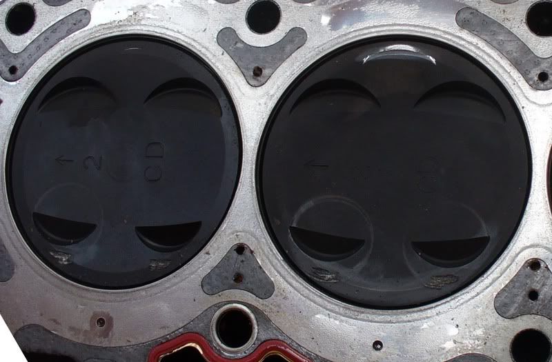

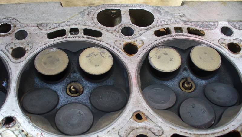

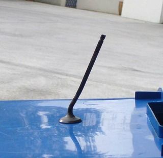

here are some pictures of the result.
(hope the pic sizes are ok)
See where the valves contacted the pistons,
and what happens to the valves,
and the valves still in the head.
The engine was running fine, had done about 2 hours at the track when it had a cam timing problem up the back straight.
made no weird noises, just stopped like the key had been turned off,
and then had no compression.

What head was that silvertop or blacktop? And how long had it been running for until it kicked the bucket?
TRD_ZERO
Posts: 1077
Location: Howick
Postby Lloyd » Tue Oct 24, 2006 7:46 pm
Looks like silvertop, and it says 2 hours up there though that could be just track time and not overall time
Postby matt dunn » Tue Oct 24, 2006 11:37 pm
HRT wrote:Looks like silvertop, and it says 2 hours up there though that could be just track time and not overall time
Yes it was a silvertop,
and it had only done 2 hours since a full rebuild and it was all track time.
Most of it at low boost setting, 10 psi or so, and the last 1/2 hour at 18psi.
And all four pistons are marked the same, and are all being reused.
Matt
