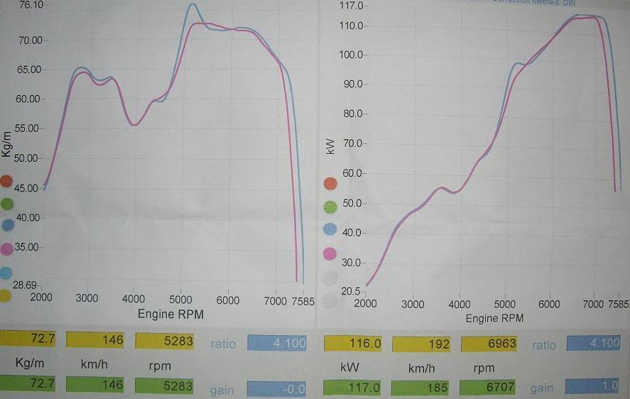

Postby Titties » Tue Oct 23, 2007 9:46 pm
stock altezza rs200,
pod filter only
note the torque/power drop, not sure whats causing it.

Postby RomanV » Tue Oct 23, 2007 11:24 pm
Ehehe, I wish there was an air/fuel ratio chart to go with it.
From personal experience, (AKA about 5-6 dyno runs with different configs) my advice is to put the stock airbox back in... I ended up with either 1 or 2kw more peak power, and a buttload more mid range and low end.
Take it back to the dyno with the stock airbox, IF yours is anything like mine (which is a slightly different engine, but from other peoples comments sounds equally susceptible to the same issues)
I'd almost garauntee that your torque hole will be gone, and wouldnt be surprised if you ended up with a small amount more power all across the range.
The problem is with the airflow meters.... When they get unexpected turbulence in the intake pipe (usually thanks to changing to a pod filter etc) The engine starts thinking that all sorts of crazy things are going on, and it wreaks havoc with your fueling, igntion timing, cam timing, etc.
Stock airbox = problem solved. I had 10KW ATW more than yours (running through a transaxle though) with a stock airbox, and a repco panel filter. hehe

Postby RomanV » Tue Oct 23, 2007 11:54 pm
Yeah that's the thing though... the butt dyno doesnt always tell the true story.
MY car felt slower when it picked up heaps of low end and midrange, because it felt like it had less of a 'kick' when it got to high RPMs.
But the dyno (and track times!) showed otherwise. :o
Yeah, once you're sorted with a powerfc, it probably wont matter about your possible intake problems, it's only when interfacing with the standard computer.
It would be better to have a NON turbulent intake tract, but you can tune around it with a powerfc.

Postby Mr Revhead » Wed Oct 24, 2007 1:20 pm
throw away the pod and clean the MAF sensor with some carb/throttle cleaner. reset ecu
altezzas are well known for not liking pods/aftermarket filters
does weird stuff to the MAF.
also check that the VVT is working right
