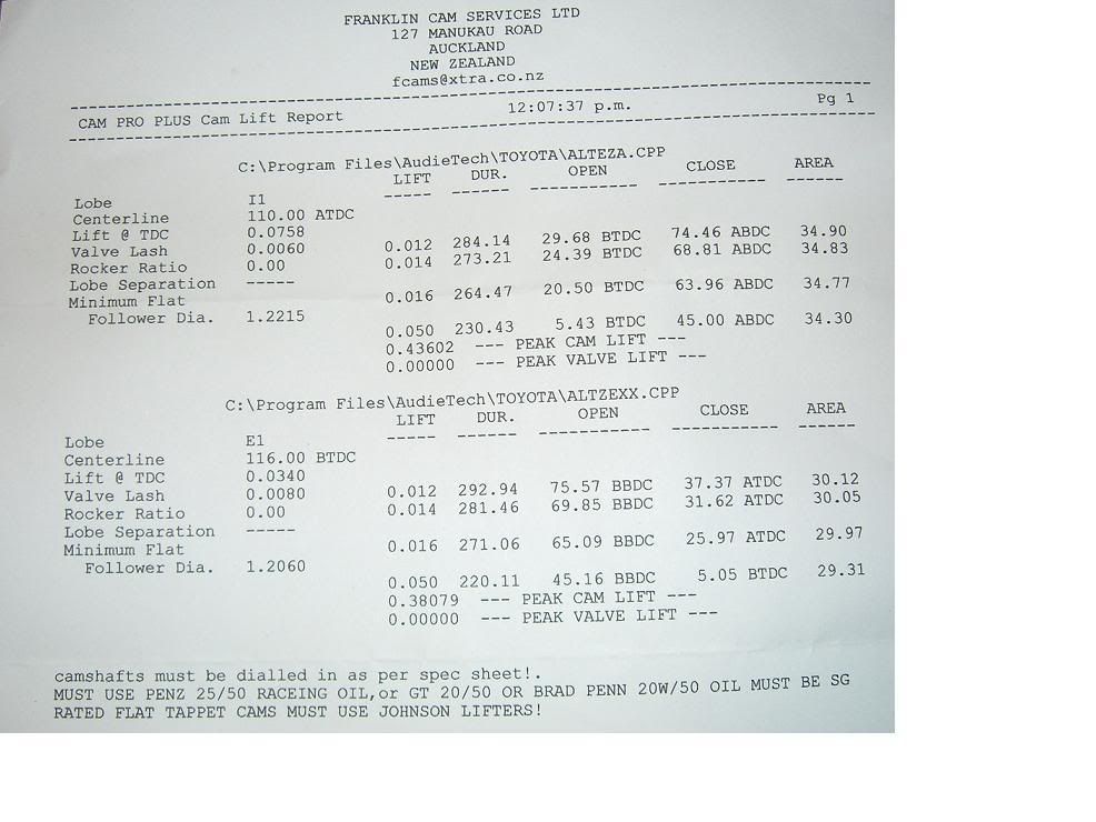

Postby Titties » Tue Sep 30, 2008 10:54 pm
Here is a spec sheet to backup any info we already had.
duration can also be changed via shimming.
