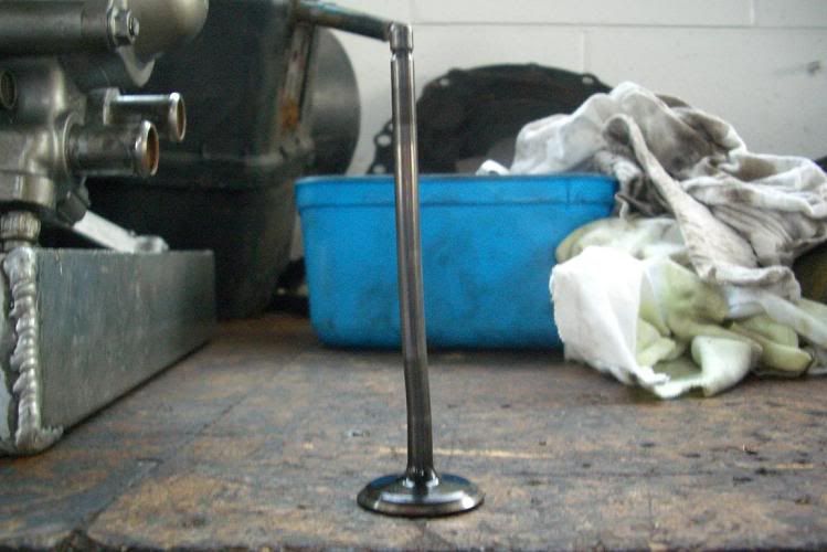

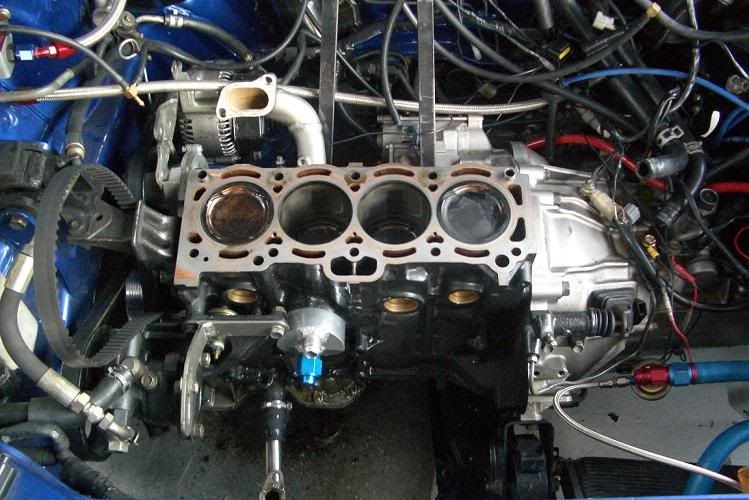

Postby Bazda » Sat Jul 15, 2006 4:57 pm
right, seems like im pretty lucky once again.
Collets fell off the valve, piston bent the valve to a nice S bend.
Basically its valved bounced, the springs cant hold the valves for this amount of boost.
So some stronger valve springs will be going in soon :D.
Anyone know where to get them for a good price?

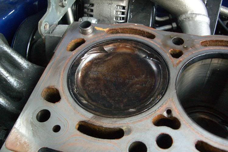

Postby Bazda » Sun Jul 16, 2006 10:42 pm
here some pics of the bent valve, and you can also see the mark on the piston where its hit.
Just as well they are tiny valves and they only just hit my pistons so no real damage to the pistons.
