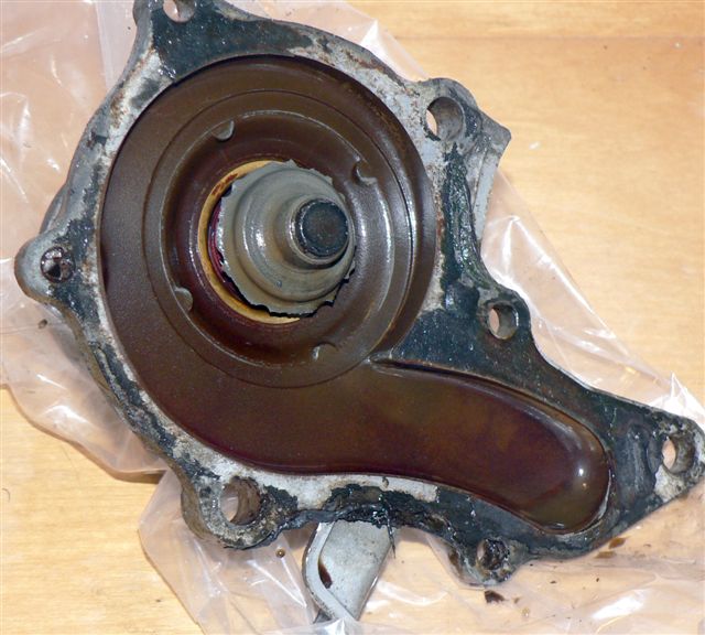

Some weeks ago the radiator blew in my daily driver 101 corolla , so I got a new one and fitted it , only to find the bottom of the radiator , lower hose and heater didn't get warm , so I replaced the thermostat and the same thing still.
At that stage I figured it was the water pump but I hate working on daily drivers ( I have projects / race cars for car work :lol: ) so it sat in the driveway for the last month.
Today I finally got around to inspecting the water pump and as expected it's not the healthiest , probably time for a new one I think :-)

Lots of impeller action going on there

Stott69 wrote:Lots of impeller action going on there
Yes , trouble is I don't know where they went , must be a private party :lol:
