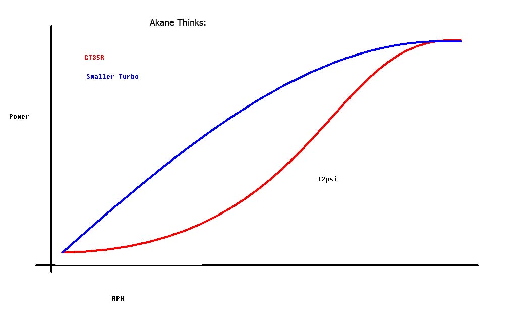

Postby Akane » Sun Feb 25, 2007 12:21 pm
Correct me if I'm wrong, but I think this is what's going on, due to "The turbo blowing hot air":
And I think it's bollocks when the 1UZ-FE is on it's standard VE, where it really is a 2x2L (460hp / 2 = 230hp each bank):
Is this right?
Postby Adamal » Sun Feb 25, 2007 12:44 pm
I'd agree with that. If the smaller turbo can make the same power at the same PSI (Although you'll be closer to maxing the smaller turbo out), the smaller turbo would be the way to go, as the bigger turbo has more mass, and requires more flow to bring up its rotational momentum.
The energy required to make the smaller turbo get up to optimal rotational momentum and overcome the boost threshold would be a lot lower.
Now if the bottom end had been rebuilt with stronger stuff (Not to say the 1UZ isn't strong in its stock form), and the head had been given some work and higher lift, longer duration cams, then the engine could support more power than it currently does, which is where the GT35R's would really be pushed to assist in making big power. Then you could shut the wastegates a bit more, letting more exhaust gasses spin the turbos rather than being wasted, and probably get a better response than the current setup.

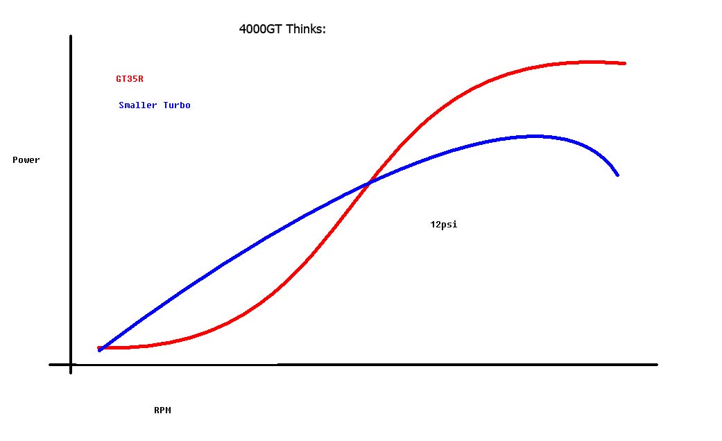

Postby 4000GT » Sun Feb 25, 2007 12:44 pm
Replace power for CFM. And the reason isnt solely because a smaller turbo will blow more hot air relative to a bigger turbo. I believe a bigger turbo pushes more CFM. If I read your chart right, thats basically what I am thinking and what I understand the other side to be explained.
Remember VE IICR is 3456 X cubic feet per minute / cubic inch displacement X RPM... the "standard' 1UZ VE is a function of the CFM...
Which is why I believe the GT35's turbo would make more power at the same boost, the engine is breathing more air. See what I mean? I could be wrong and are happy to be schooled here if someone knows otherwise.

Postby 4000GT » Sun Feb 25, 2007 1:04 pm
Adamal wrote:Hmm... Check your links out, they don't seem to be working. Well, for me at least!
I understand what you mean about bigger turbo's flowing more air, but given the same engine specs, where only the turbo's are different, and you're running the same PSI, lower down in the rev range, the smaller turbo will spool quicker and essentially provide more CFM of air at that point than the bigger turbo.
yeah cant get the pics to work, yes I agree in the lower rpm range (as in the diagram drawn), the smaller turbo would flow more CFM, but proportionally the larger turbo will flow more at any given psi but make those psi later, but ultimately make more power when spooled (in fact just prior). Keep in mind those ball bearing Garrett's spool pretty well.

Postby Adamal » Sun Feb 25, 2007 1:09 pm
Yea, could definatly make more power, but with the engine in question, I don't know if it would be able to make much more power without causing some serious damage.
I think what Akane and vvega are getting at is that the GT35R's are a bit overkill for the engine in its current build. If it were built tougher, then they'd be great :)

Postby 4000GT » Sun Feb 25, 2007 1:14 pm
Adamal wrote:Yea, could definatly make more power, but with the engine in question, I don't know if it would be able to make much more power without causing some serious damage.
