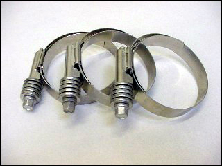

Postby pureadrenalin » Sat Feb 21, 2009 2:39 pm
l1ttle_d3vil wrote:http://www.clampperformance.co.nz/
thats a local guy here who sells them, im going to go see him in the next couple of weeks for all mine. his prices seem alright compared with other ones ive seen on TM...
Those are good (if a bit of an overkill), but the problem with them is you can do them up too tight and crush your piping. Most people get a bit over zelous, and this is what happens.
I use constant torque ones :
