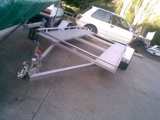

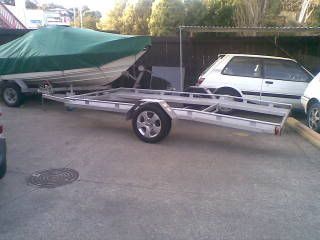

Postby fxgt race » Tue Aug 11, 2009 6:01 pm
I had this made to fit my car, the deck is 1760 by 3600. mine has 4x114 stud pattern,I put the wheels on, Had the guards put on at a height that i could still open my doors, my car is 800kg, tows mint.
I didn't want double axle,to heavy, a pain to turn around off the car, this is lite,I can pull it around by myself and good to tow.It came wired , braked, but only painted for $2600 a year ago, $700 to get galved,I know he doesn't do them for this price anymore.
