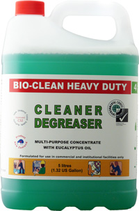

Postby Dell'Orto » Sat Jun 28, 2014 11:11 pm
http://www.insinc.co.nz/webapps/p/78684 ... nleaf.html
This stuff here is one of the gruntiest degreasers I've ever used. I sat a set of 5K pistons in it overnight, and they came out like new. I didn't dilute it at all though, which is probably why it worked so well. Smells good too!
Re: How to clean engine parts covered with black burnt on oi
Postby Adoom » Sat Jun 28, 2014 11:18 pm
Dell'Orto wrote:http://www.insinc.co.nz/webapps/p/78684/149131/Bio-Clean-Degreaser-5Litres-Greenleaf.html

Postby Dell'Orto » Sun Jun 29, 2014 11:37 am
How bad were those pistons? Just oily, or real burnt on stuff?
Coked up massively, probably 200k worth of running. It only left small dots on the crowns, which came off easily with scotchbrite

Postby Adoom » Tue Jul 01, 2014 10:31 pm
So I got myself 5l of the Bio-clean that Dell'Orto recommended.
I chucked all of the pistons in a bucket and poured the Bio-clean in straight. Wow, after only a few minutes the varnish stuff inside the pistons just brushes right off!! And they smell AMAZING! :lol:

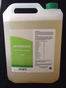

Postby jondee86 » Wed Jul 02, 2014 9:32 pm
There appear to be two similar products on that website...
This one... Bio-Clean Degreaser - Greenleaf (GE-Bioclean)
... and this one... Bio-Degreaser - Insinc (INS BD5)
Any particular reason for choosing one rather than the other ?
Postby Dell'Orto » Wed Jul 02, 2014 9:52 pm
I used the former, purely as it was what was on the shelf at Bay Engineers
