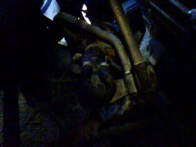

Remove everything plugged into your throttle body (just unplug TPS, dont remove it). There is a small coolant line to and from the bottom of the throttle, just loop this back to itself on the main coolant hoses below:
(loom is kinda blocking pic a bit - its the line with the white dot):

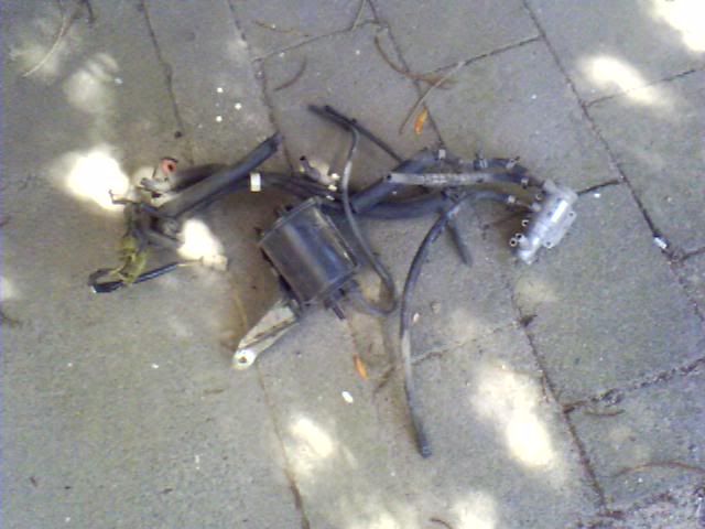

Remove the charcoal cannister (black plastic box by passenger side strut tower). This is bolted to the car at 2 points, and the rear of the bracket shares a bolt hole with and is tack welded to the fuel filter mount, cut thru this so the fuel filter still mounts fine. Take the thick line from the top and feed it back thru the hole where the bottom line went (down to the road). *** Install a small plastic fuel filter in this line that vents to the road - you can get them for only a few bucks *** This makes sure the gas tank still vents safely. There is a solenoid for the charcoal cannister, unplug/remove this solenoid and its lines, the ecu wont care.(sorry dont have a pic).
Remove the shit with all its lines behind the passenger side strutt tower. This stuff appears to be the A/C and econ A/C idle up stuff. Unplug as i have, remove 2 bolts and remove all its lines with it.

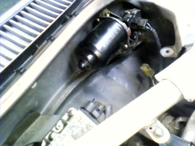

By now you have probably removed the single line that goes into the intake just after your pod filter, this is the feed for most of this idle up gear you've removed. Since you've got this hole in your intake now, cut off the 10mm or so of rubber hose sticking out, drill it out with a 10mm bit and shove your intake temp sensor back in here. It'll fit snug. If you're like most people (me) this temp sensor has been floating around your engine bay ever since you got rid of the stock airbox. May as well put it back in the intake line where its supposed to be:
Nice and tidy.
This is what you should've removed:

Postby matt dunn » Sun Jan 08, 2006 9:10 pm
gmacrae wrote:nah, get rid of it, have done on the supra, ran it by a bunch of people and nobody could come up with a decent reason not to :D
except that when you use fuel from the tank you need to let air in via that pipe.
You are now letting air and dirt into your tank.
Postby gmacrae » Sun Jan 08, 2006 9:48 pm
Ahaa! I put a little filter on the supra's tank vent just incase something like that might happen but haven't on the FX. Cheers Matt will do the same there :lol:
