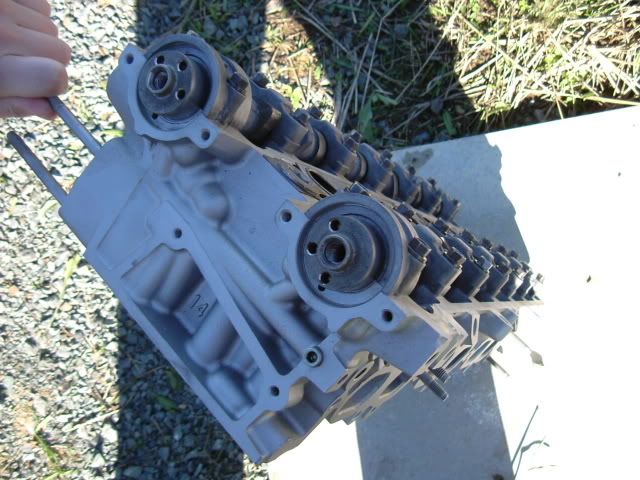

Postby deaf_rattle » Wed Jul 12, 2006 8:34 pm
well in that case, you should do what ive just gone through
The head has been hot tanked and bead blasted. The valve seats have been lapped. The deck has been skimmed (ready for HKS mhg) The cams have been polished. valve grind.
all up cost me less than $500 looks a million dollars now too
