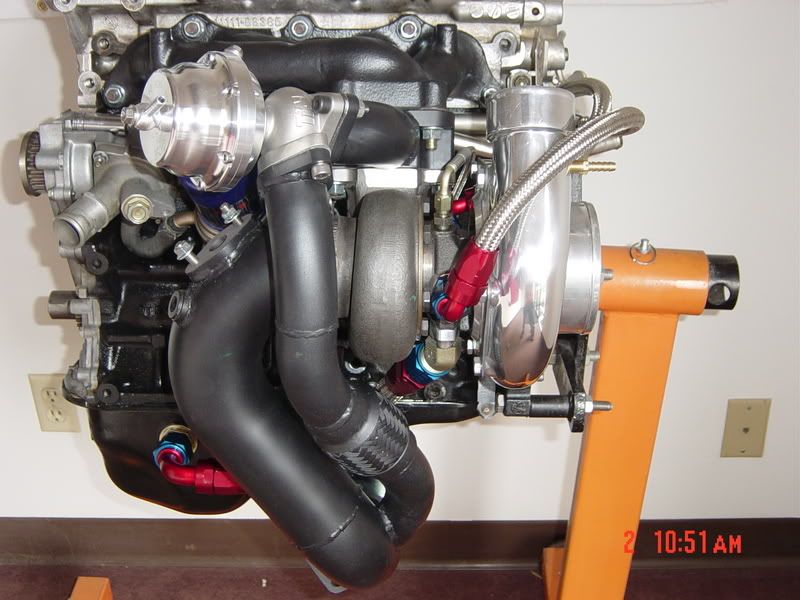

For a street driven car a GT28RS would be the way to go, (im contplating making a "kit" for my MR2)
but if you want to go down the 600HP route later in its life, the turbos to go for would be like a GT3582R
(GT3540R) with a .82 housing or a T04Z with a .7 turbine housing.
This is what you are looking for a GT3582R kit that bolts on to the 3sgte (this one is a gen2 kit).
i would personaly stay way from the cheaper turbos (not just because i sell geuine Garrett, Mitsubishi, IHI, Borgwarnger, & Holset turbos but becasue of what i have seen of them failing & how many enquries we have for parts for them). i'll pull some facts & figures on monday about how much R&D goes in to developing a turbo,
i thing i do know (off the top of my head) Holset have a test bench in which they perform a containment test, they spin the turbo as fast as it can go before it explodes, and the compressor & turbine wheel must stay with in the covers, they tested one of there H2 series turbos they spun it to over 400,000rpm...!!!
hey then tryed a cheaper one (made to replace a holset model) it managed to destroy the test bench. and didnt make it near 250,000rpm.
i'll dig those facts out & post them up...
