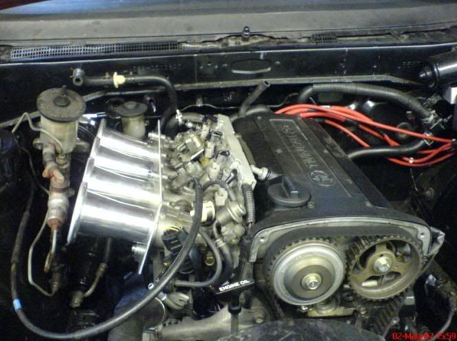

If it helps, this is how our blacktop in our AE110 has the intake set up
(yes i realise the catch-can is set up wrong, i was correcting it in that photo :D )

Postby Loudtoy » Sat May 05, 2007 9:04 am
Hey thats almost exactly the setup i had in my 101 with sivlertop only my intake pipe was bigger and was one mandrel bend and i also had the afm as well obviously.
Btw it works even better like this if when you are at a track event or some sort of speed trial if you take the left hand headlight out.
To give anyone looking at this a rough idea of cost for me it was
$47 for the battery box to relocate battery
$30 for the cable to move battery to boot
$60 for the circuit breaker
$15 for the pipe
Free stainless for the heat sheild
$23 for the two joiners i needed to join pipe to inlet plenum and afm
and i got given my catch can for my birthday from my little brother so not sure how much
$80 for the pod
$100 for 2 dyno runs before and after
Total gain for pod system nearly same as above was 4kW atw :)
May have been slightly colder on second run as one was summer and one was winter but not 4kW worth in it
