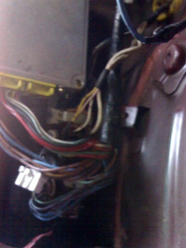

Postby rollaholic » Sun Jul 22, 2007 2:34 pm
well, after the last breakdown i spoke to an auto electrician who said these cars often suffer from an ECU fault. i gave him the ECU and he got it checked, apparently there was some fault and so it was repaired - despite the expense i felt it was a better option than replacing it with another secondhand item of unknown quality.
the car has been fine for a week or ten days, till it did its old trick again last night. once again it was in the pouring rain, and once again it started again by itself after 4 or 5 hours of sitting - and once the rain had stopped too, incidentally.
im starting to feel like it is associated with water getting in somewhere, despite my earlier misgivings. whats the stuff in the picture below, next to the ECU when its wet water sometimes pools below that stuff - im not 100% sure on where its coming from yet. could this be the source of my problems?
Postby WeirdGTi16 » Thu Jul 26, 2007 12:21 am
This sounds like Distributor fault - had same problem with AE92. Ended up replacing distibutor as fault inside dizzy wiring. Dificult to diagnose because intermittent fault. So Auto sparky needs to check when engine dies :lol:
