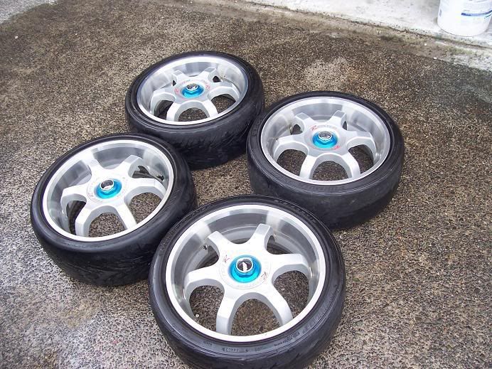

Postby Boosted_162 » Sat Aug 18, 2007 10:53 am
They were +38 offset, with a good 2" of dish..

Postby Boosted_162 » Sat Aug 18, 2007 6:29 pm
Snoozin wrote:That doesn't count as dish. That's pretend dish :lol:
Its the closest thing to dish on a FWD/4WD :lol: :lol:

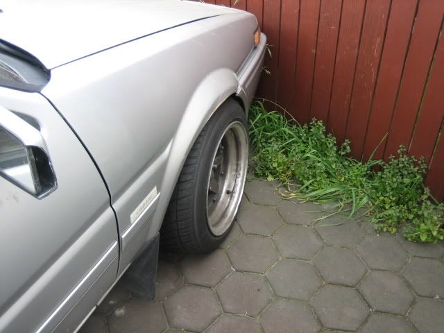

Postby frost » Sat Aug 18, 2007 9:08 pm
LOL thats not dish, thats a wheel with a gutter
this is dish...
Postby Boosted_162 » Sat Aug 18, 2007 9:32 pm
But they have a really low offset don't they? He said for FWDs, and RWD ones stick out too far. The pic i posted is FWD offset. Without some other mods, RWD wheels with dish just wont work.

Postby scope » Mon Aug 20, 2007 5:30 pm
frost wrote:Image
have you ever hit your fence? :lol:

Postby frost » Mon Aug 20, 2007 8:05 pm
have you ever hit your fence? Laughing
haha you can just see a blade of grass between the bumper and fence,
romanv speaks the truth :twisted: :twisted:
