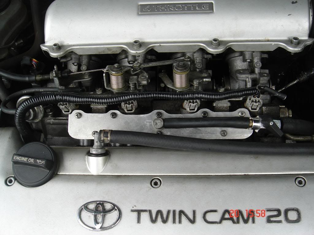

Postby gmacrae » Wed Jan 16, 2008 11:26 pm
hooked it up like suggested, no probs. I also made up an alloy plate to replace the whole top half of the vacuum chamber too, with a single 6mm vacuum line into the centre for my idle 'ball valve' (instead of the 4+ factory lines that were all plugged (all idle-up/evap sh*t removed). Looks heaps tidier and the car seems to like it. Let me know if anyone wants a pic

Postby AceSniper » Thu Jan 17, 2008 5:33 pm
give us a look :)

Postby gmacrae » Sun Jan 20, 2008 5:05 pm
here ya go, definitely looks better than the ugly stock bit. I was only using one vac line into it anyway for the ball valve, IAC valve is buggered but these dont need cold idle compensation anyway if the ignition is good. Also got rid of the shroud around the injector wiring, replaced with loom shieth stuff - heaps tidier. Keep in mind im not running a/c or powersteering tho.
