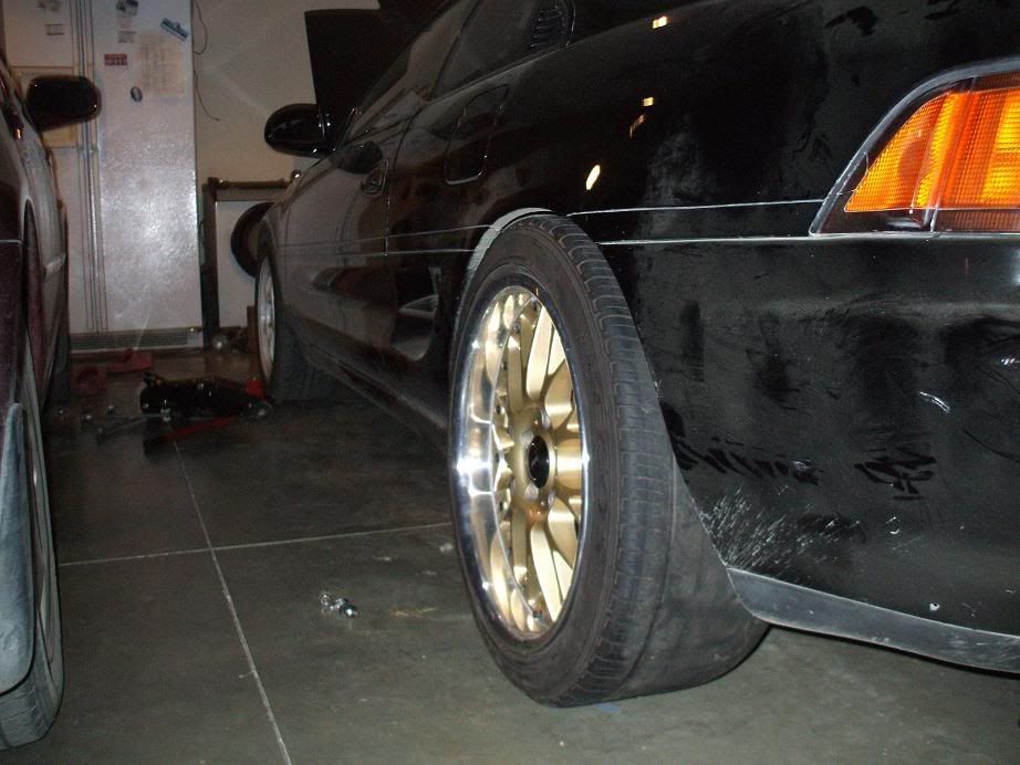

Postby Boosted_162 » Wed Jan 30, 2008 10:03 pm
Sorry to steal your thread..
I have my hands on some 18x9 wedsports.. now the backs fit wickedly awesome, but the front hits the spring perch.....and i mean hits :P. Now the tyres are all 245/40/18s (off a GTR). Im not sure on offset, but it looks like it wont hit the strut anyway (im guessing a low 30 at least, ill measure tomorrow) . If i got say a 215/35 tyre on there, would i be able to fit it under? Or would adjustables make them fit? I love the wheels and really wanna use them.
EDIT: tyre calcs say theres nearly a 2" difference between a 215/35 and 245/40. If it clears the strut, is there any other problems running a 9" up front?

Postby Boosted_162 » Thu Jan 31, 2008 5:27 pm
That looks like mine :lol:. I managed to get them on (when i let the tyre down :lol:). The wheel is a good 1cm from the strut tho so woudnt need a spacer. Just need a smaller tyre haha.

Postby Boosted_162 » Thu Jan 31, 2008 5:54 pm
rollaholic wrote:it might fit in your driveway, but have fun driving it like that :P
Haha yeah :lol:. Guards are gunna have to be modified. needs to go into the panelbeaters anyway sometime to paint the front.
Postby postfach » Thu Jan 31, 2008 5:55 pm
Spring perch moves with the wheel, so as long as it doesn't foul while stationary it wont hit while moving. The problem (from what I see) will be the front guards. Even if you stretch narrower rubber on there, it will probably still rub on the outside edge going over bumps/cornering

Postby Boosted_162 » Thu Jan 31, 2008 6:12 pm
Spoiler might go back on :lol: :lol:. Was thinking about it earlier...
Yeah the problem is the wheel rubs on the perch. I could set my koni's to hard and it prolly wouldnt hit the guards :lol:. But i dont mind getting the guards slightly cut seeing as it has to go get fixed anyway. Front tyres are bald and far too big anyway ( 245/40/18 ) so will get replaced anyway.

Postby Akane » Thu Jan 31, 2008 10:46 pm
Your front offset looks whack dude. Sticks out too much, it's illegal too IIRC, unless you flare out the guard
Postby Boosted_162 » Thu Jan 31, 2008 10:49 pm
Akane wrote:Your front offset looks whack dude. Sticks out too much, it's illegal too IIRC, unless you flare out the guard
It seems to be perfect, its just the wheel is a bit big :lol: should really be 8"..
It will be getting flares and/or modded guards when it goes in to get the front fixed.

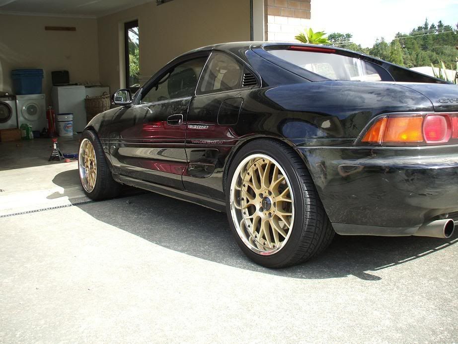

Postby Akane » Fri Feb 01, 2008 2:30 pm
You mean your wheels are not staggered setup?
Last time I saw a MR2 with "RWD/4WD" all 4 wheels the same size, it looked mega rude, looks like someone smacked the rear wheels in with a big sledge hammer.
Gonna make the rears stick back out a bit?
Postby Boosted_162 » Fri Feb 01, 2008 3:04 pm
Yeah they are allthe same size unfortunately. When i get the guards done/flares im gunna get a 10mm-ish spacer...i hate the front sticking out more than the back :lol:
