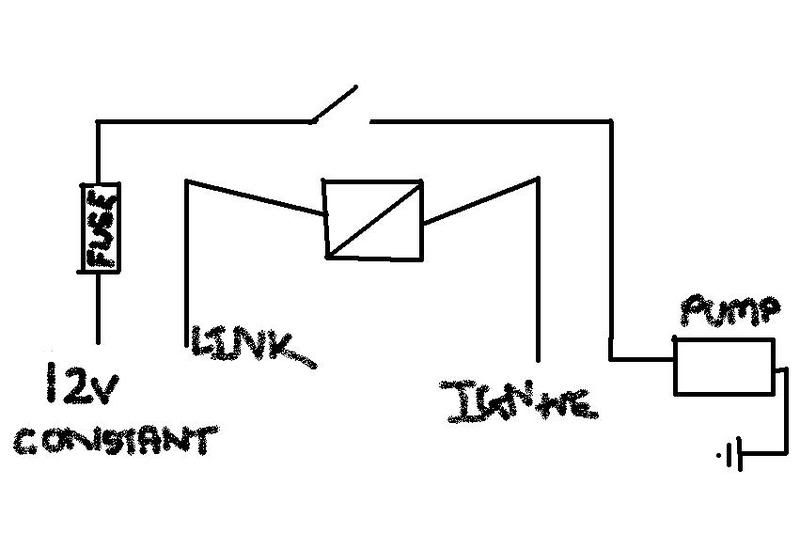

well, i just sorted my problem, i ended up ditching the std fuel pump relay as it was being a c##t.
used a spare horn relay i had, and wired that in as follows for anyone interested, excuse the awesome paint skills
there were two wires left over from the standard relay
big black and white wire - only had +ve 12v in the start position
little white and black wire - think it's an earth, but didn't need it.

Postby IH8TEC » Wed Feb 13, 2008 7:24 am
so why does the std relay not have a constant 12v source like i needed on the new relay?
thats what i couldn't figure out when trying to sort the thing.
also is it worth hooking that earth wire up to an earth? cause it's still earthed at the pump, or do i not need to bother
