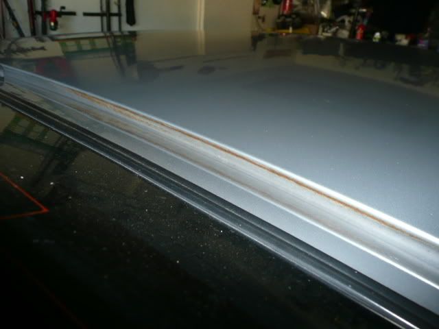

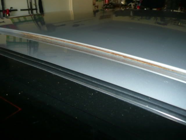

I have just noticed when I lifted my boot that there is a bit of rust on the roof of my AE101 Corolla (1993) Its just surface rust at this stage but who knows... It's only really noticeable when the boot is lifted half way up and you can see across, is this a problem? bad? How to treat or fix? thanks
This is the first time ive posted photos so I dunno if they work but here goes
Any help greatly appreciated!
Josh

id give it a sand with some light sand paper and put a coat of PA-10 or another primer on it, just to inhibit it for a bit

^^^agreed, just remember to mask off your roof and interior

i'd get a spray can made up and paint it too, wouldn't even know its been done that way.
plus you can touch up ya stone chips with the rest of the can 8)

where abouts is that done? - Good idea! Cheers!

you can get paint mixed up at lj smits in east tamaki,
great guys great service, wouldnt go anywhere else for paint

Depending on where you are Car Kolour (If you look for the name try switching the K and C round, or they might both be K's :oops: ) in Albany do it too.
Make sure you're getting automotive paint, not house paint :P

I got some el cheapo at surer cheat... Noooooo not the $4 cans... the $10 actual car paint thats matched to your car.. well in my case semi matched but hey its not like its gunna be seen!
Fricken forgot the wet and dry so wont be doing the job tonight! What a knob!
