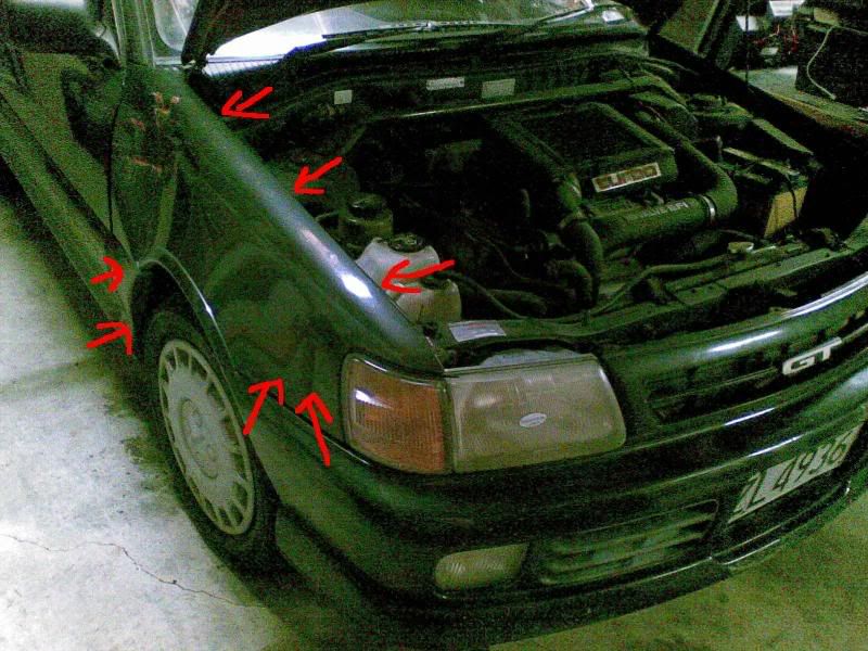

My flatmate needs the fender replace on her car, first up, where are the bumper bolts? It's all original so all the plastic shielding is still on, I presume the lower skirt pulls off (I have taken all the bolts from it off and begun to peel it back, looks like some adhesive holding it now)
I just didn't fancy pulling everything off to get stuck with some mystery bolt. The old civic bumper practically falls off then the fender bolts are all exposed once you pull the door pin!
Cheers Cam

check higher up nearer the a pillar, like behind the mirror, and also check behind the flasher , a bit lower, i think my corolla had one in there, kind of attaches to bracket thingy. uh not the best explanation but yeah. only adhesive should be along that bonnet edge.
