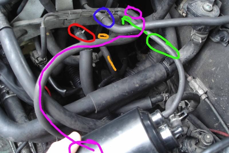

yea i checked the afm wires, i think i may have got sum hoses mixed up when i put the engine back in, i tried to find pics showing these in the correct places but couldnt find any. heres some pics of mine.
the purple ones going to the bottom of that canister thing

Postby Chris.W » Thu Sep 17, 2009 4:25 pm
thanks ill give it a go, im pretty sure i had them right, but cant even get it started now

Postby sergei » Thu Sep 17, 2009 4:43 pm
Ok here what I can tell you (hard to see with that pic).
Orange is PS idle up.
Orange goes in right place.
Orange line should have a pair where it goes back to rack.
The Orange counterpart should plumb where the pink line is, meaning that Pink line ultimately will go on the steering rack.
Blue line is AC idle up.
Counter part of Blue line should go into the AFM elbow
Red is fuel return it looks like it goes to right place
Green line us purge, looks like right in the place.
