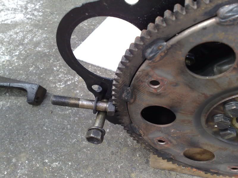

Postby frost » Fri Oct 30, 2009 3:37 pm
please do not post, i will update with more how to for the tech faq,
to undo flywheel bolts with out any special tools, simply use two of the big bolts from the bellhousing to engine, i used the top two, they have a dip in the heads to snugly fit the flywheel teeth, thread one in the wing and lock one in the teeth,
place on exhaust side to undo and intake side to redo,

Postby frost » Sat Oct 31, 2009 9:44 pm
yeah i got super frustrated after trying to wedge screw drivers and claws and crap to lock it, then settled down, sat there thinking about it and :idea:
