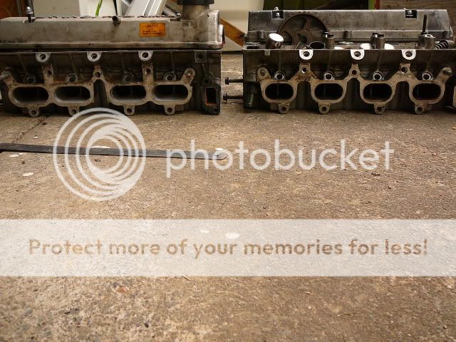

~SlideWays~ wrote:Be carefull with smallport vs bigport fuel rails because the injector spacing is different.
i found no such thing
Yo mutha!
I've got both big and smallports in cars at home, both 4agze.
Plus both types of fuel rail as spares...if I can find them :lol: I'll see if I can take some pics.
Hopefully my memory serves me right :lol: :wink:

Actually I might as well just take a pic of my spare heads because I actually know where those are :D

Postby ~SlideWays~ » Thu Nov 12, 2009 9:18 pm
bluemaumau wrote:that would be awesome.
interesting that they made them different....
strange thing to do
I think its because the injectors are centred on the intake port and since the smallport has...smaller ports they are positioned differently.
...uploading pics now.

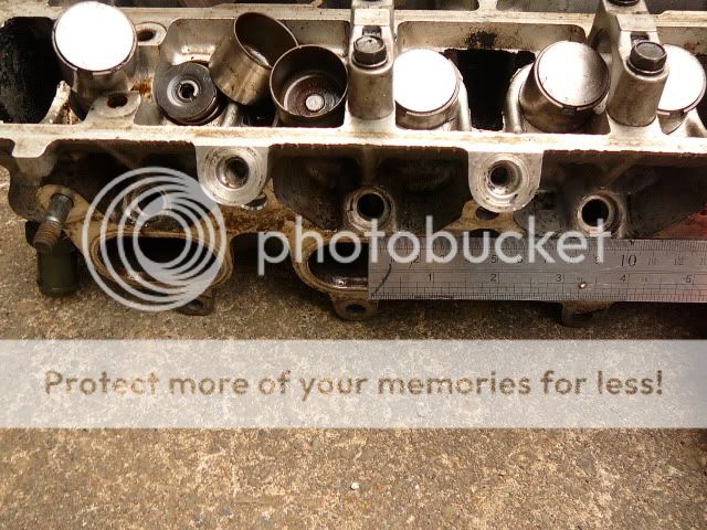

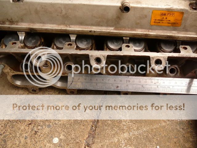

Postby ~SlideWays~ » Thu Nov 12, 2009 9:22 pm
Bigport:
Smallport:
Side by side, you can clearly see the difference in injector port position, especially the two inthe centre, which is why the fuel rails aren't interchangable.
I can't find my spare smallport fuel rail at the moment but you get the idea from the heads anyway.
