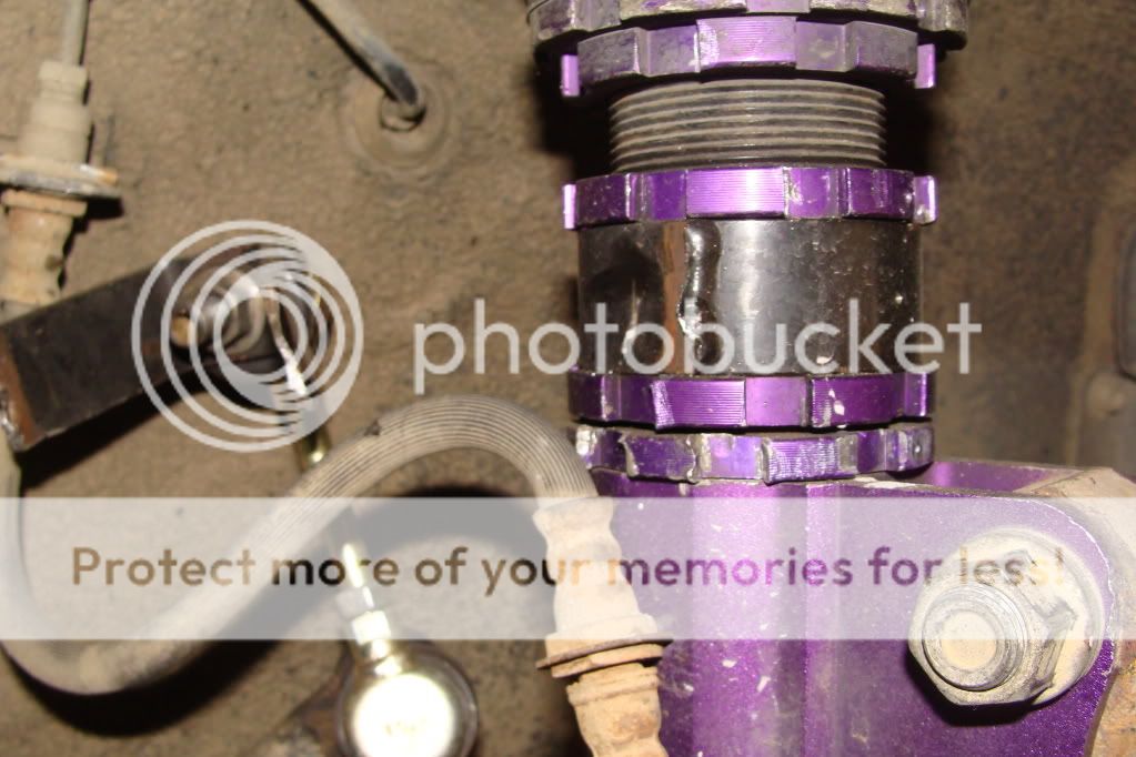

Here's what happened to mine. Links were too short, so it broke the bracket off the strut on both sides

Postby Adamal » Thu Mar 11, 2010 10:44 pm
Are those D2 coilovers?
Postby MR2BOY23 » Fri Mar 12, 2010 7:22 am
Adamal wrote:Are those D2 coilovers?
Correct

Postby 1I1 » Fri Mar 12, 2010 2:46 pm
Is that sway bar mount on the shock removable? Looks like it. In that case it's like they were anticipating it to happen.... :D
TRD Clicky >>Here
1I1
Posts: 3063
Postby MR2BOY23 » Fri Mar 12, 2010 3:06 pm
1I1 wrote:Is that sway bar mount on the shock removable? Looks like it. In that case it's like they were anticipating it to happen.... :D
Yeah I believe it is
Got a new on tig welded up
