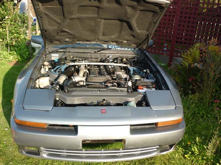

Postby mikeBrotherd » Sat May 07, 2011 11:17 pm
I just want to add my findings Ive had with my supra. Below is my current intake, came with my halfcut when i got it. I have been monitoring temps to see how hot things were getting under the bonnet, i managed to get a whopping 75~80deg! This thing was sucking in so much hot air that you couldn't touch the base of the airfilter for more then a few seconds!
Since then, i have put a small shield between the filter and the flow of hot air from the radiator and added more area to the front of the vehicle for air to enter, this got temps down to below 40deg. Big improvement in temps and i don't get a hesitation from the engine when driving hard (probably due to the ECU not pulling timing to prevent detonation).
Also a pic of a Ford Sierra Cosworth setup, doesn't look like much but has a big enough filter to supply demands and a small shield to keep unwanted heat away.
