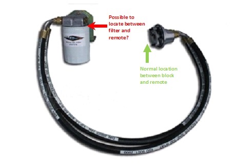

Thermo plate looks good but my preference would be to add the cooler into my existing return line from the remote. Can the sandwich plate be installed at the remote end instead? Otherwise I would probably be best to ditch my existing remote or I will end up with too many hoses to try and route around the headers etc. Although that would not be a problem, other than $$, as I have changed headers so I don't have a clearance issue with the factory oil filter location now anyway.

That's where it goes on the remote adapter where the filter is screws onto.

Bazda - meant can it be installed at the other end of the remote like the following picture as an example?
Thats what im talking about. The Thermo adapter HAS to go where ever you put the filter.
It only goes onto the block if your not running a relocation setup.
