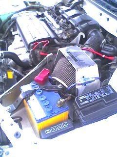

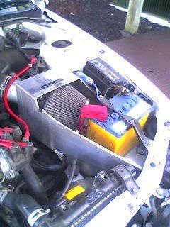

Postby bad20v » Wed Jun 29, 2005 10:07 am
Heres just an example of the cold-air box I built in my BZR....
When Im racing it, say at Puke Track, I just remove the RH headlight for better flow but it still works pretty good with the light in.
Thank-You.

Postby Malcolm » Wed Jun 29, 2005 2:12 pm
i don't get why so many people use materials that conduct heat such as steel, aluminium etc. A far better solution would be fibreglass, perhaps even fibreglass/foam sandwich construction. much better insulation, easier to make (imo), and far easier to make irregular shapes to fit around other parts

Postby bad20v » Wed Jun 29, 2005 5:00 pm
All_Fours wrote:i don't get why so many people use materials that conduct heat such as steel, aluminium etc. A far better solution would be fibreglass, perhaps even fibreglass/foam sandwich construction. much better insulation, easier to make (imo), and far easier to make irregular shapes to fit around other parts
So your saying its far easier to shape and mould fibreglass/foam and resin compounds than cutting and bending metal? I havent seen many fibreglass air-boxes around, maybe carbon fibre ones, but I think it would be alot easier to make one out of metal given the fact that you would get the similar results for each different build material. It would be cheaper to make it out of metal as well.

Postby Alex B » Wed Jun 29, 2005 5:01 pm
you could probly use your aloy one as a mold to make a fibreglass/carbon fibre one.

Going back to Santa'sBoostinSleigh & Rick's entries (though the carbon fibre aspect sounds kinda cool), that's pretty much what I was thinking about the water aspect and the extra piping involved.
Having said that, I was just thinking of putting a bloody great dividing wall between the filter and the engine, running from the firewall to battery/ fusebox, like bad20v's photo (only I have a bit more room! :) ). What I was puzzling over was whether I should put some ducting in to get more cool air into the bay without cutting holes in the bonnet, as the layout is fairly tight. Getting round the radiator appears to be the main problem, which Ricks solution appears to answer. I hadn't thought that far outside the square, but as a compromise over the water/ piping drawback, what about leaving the filter roughly where it is, and running ducting into the box?
