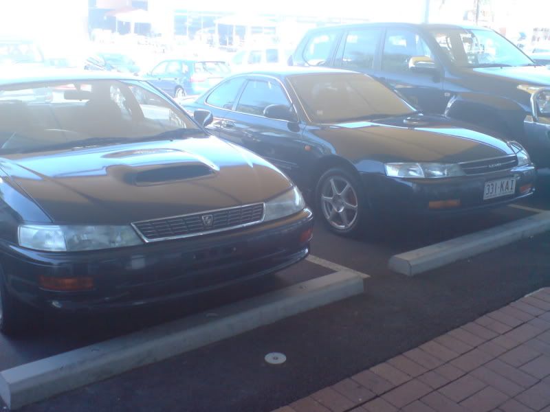

Can you believe only 4 of these here ? (in Brisbane)
my mate bought my 20v , here we are at the transport office.
