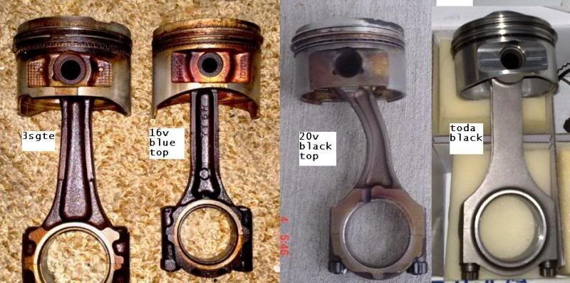

the almost none existent skirts on the blacktop pistons would slap excessively in the bore under any load, causing pitting/scraping of the bores over time, letting oil to pass the control rings.
ive seen 3 bores of blacktops now with this problem, it almost looks like a polish has been sat on a thumb sized patch on one side.
and letting them expand a little would resolve some of this.
im almost sure that's why blacktops like to drink so much magnitec.

non exsistant skirts? not that i've noticed
even for older style forged pistons, letting them warm up by idle was never the way. light load and varying rpm is the way.
things warm up faster that way, and the rings seal better

Postby frost » Thu Nov 05, 2009 12:04 pm
pics are better.
there is very little skirt under the pin, if i remember correct it was about 7mm under pin. silvertops have skirts like the 16valve engines and don't have this problem. i'll try and find a pic of the bore.

frost wrote:pics are better.
Damn that BT rod is rooted. Those toda ones look $&#$% sweet
