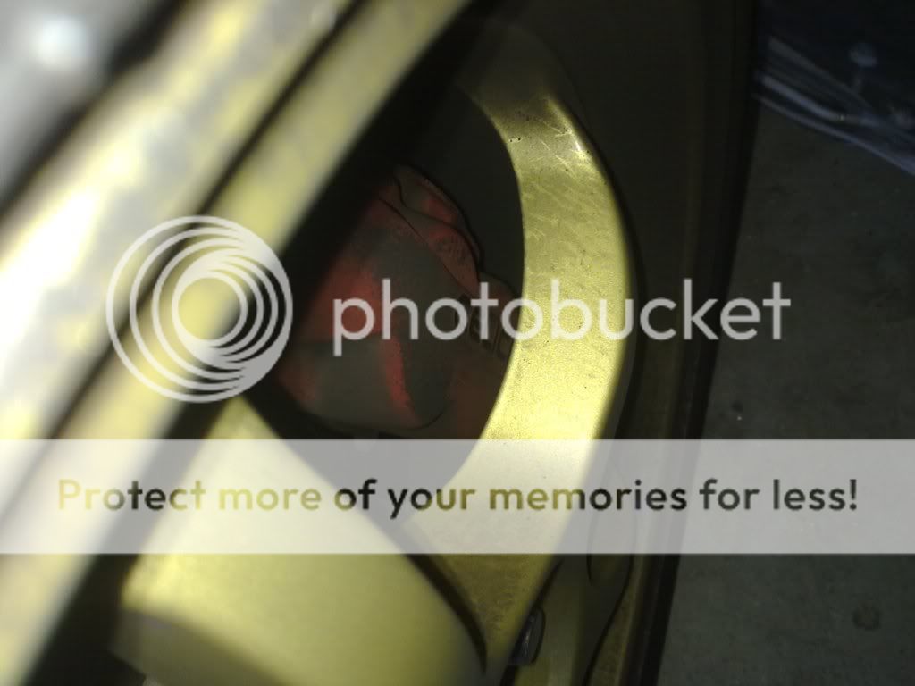

hey all, so ive had a problem with the mags i'm running needing spacers to clear the calipers which push the rim out too far, and the 225 tyres rub on the guards under hard cornering/bumps.
went to autolign on lincoln road this afternoon, the guy i spoke to said i am running "inch" spacers (35mm approx?), with a 5x100 pattern.
He used some device to measure this and that, and said i can go to a 5x100 15mm spacer. Can anybody say if this is right or not? seems like a bit of a drastic jump and there is about 13-14mm space between the rim spoke and the caliper as it stands now. Anybody able to shed some light on this?

Postby xsspeed » Wed May 19, 2010 5:03 pm
Do you have a cert for your spacers?
Max certable for boltin spacers iirc is 25mm which also = 1 inch
Postby ihavelift » Wed May 19, 2010 5:08 pm
so if i get narrower ones it can't be certed?
and no not certed, never been a problem so not bothering with it

Postby touge_ae101 » Wed May 19, 2010 5:10 pm
that would make sense, inch = 25mm, 25-10= 15, so you will still have 3mm clearance between caliper and wheels. :D

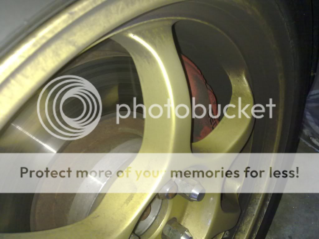

Postby ihavelift » Wed May 19, 2010 6:00 pm
just so i don't make a mistake, does anybody know what stud pattern these rims are? 5x100, same as the st205 stud pattern? or am i after adapter spacers to 5x114.3 or something?
here's a better pic of the mag:
They're advans, but not sure what model

Postby 1I1 » Wed May 19, 2010 6:02 pm
Advan RG's
TRD Clicky >>Here

Postby touge_ae101 » Wed May 19, 2010 6:06 pm
when you take those spacers off the front you should chuck them on the rear!wheel looks a bit lonely from this angle, needs to get up close and personal with panel!haha
google is your friend:
Toyota Celica GT4 ST205 facts and figures
Inducer size, 48mm, The largest of all the GT4 turbo inducers. Inducer configuration, Twin 5 blade ... Wheel stud pattern, 5 x PCD 100, Studs are M12x1.5mm ...

Postby ihavelift » Wed May 19, 2010 6:09 pm
haha yes that is what i am wanting to do! i think it looks lonely too, will need to roll the guard though.
so what's the stud pattern on an advan RG? 5x100 or 5x114.3?

Postby touge_ae101 » Wed May 19, 2010 6:13 pm
:lol: :lol: glad to hear!
depends, RG, like most wheels are made in a variety of different stud patterns and offsets. can get 4x114 etc etc. easiest thing to do is to go and measure the wheel nuts centre to centre (as accurately as you can)
but you should easily be able to figure it out cause it will be either 5x100 or 5x114.

Postby touge_ae101 » Wed May 19, 2010 6:16 pm
i'd say you could get away with another 25mm in the rear without rolling gaurds. 25mm isn't much when you look from a distance.
even if you get slight rubbage just sort it out with a heat gun and a soft rubber mallet. :lol:

Postby ihavelift » Wed May 19, 2010 6:18 pm
fyi 5x100 :D
and as for rears, we can always see what needs to be done
