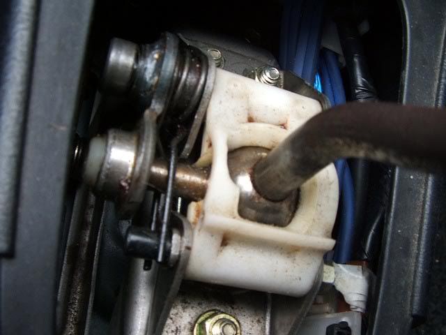

Postby 4000GT » Sat Apr 29, 2006 9:52 am
Sergei,
Do you have a pick of the modded mount? The old gearbox is out in my car, new clutch is in, 6 speed shifter and linkage in, but the mount (third one) may need to be forgone. Which may not be a big deal.

Postby sergei » Sat Apr 29, 2006 10:26 am
I will do pictures as soon as I can...

Postby sergei » Sat Apr 29, 2006 9:35 pm
I used AE101 CVs/shafts with no problem, BZR comes with Torsen LSD so shafts are of same spline length.
Here are the pics:
