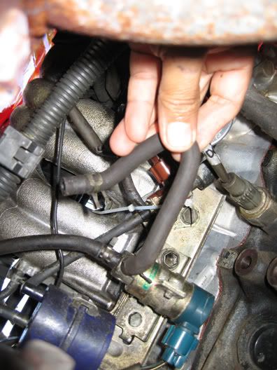

Yep, although you'll need to remove your boost tap, as thats where the factory BOV plumbs back into.
Just run a pipe from where the filter currently is on your BOV into where the tap is. Not terribly tricky.
Postby mr2--mad » Sat Nov 11, 2006 4:00 pm
theres an also a bigger hole underneth the boost tap that is plugged with a white plug ?you can just see it in pic .Can i keep the boost tap and plumb my BOV back to that?

Postby Dell'Orto » Sat Nov 11, 2006 4:07 pm
Ah yup, sorry, thats the one you want 8)

Thanks pureadrenalin, that install guide was very informative. Basically I need to Plumb my BOV back to intake disable the TVSV 8O , Get an acurate boost gauge.and see what that tap of mine does because it has a ball and spring in it already! an its installed in the same place!. Will a new autogauge for 30$ (TM) do or should I get a better brand?
