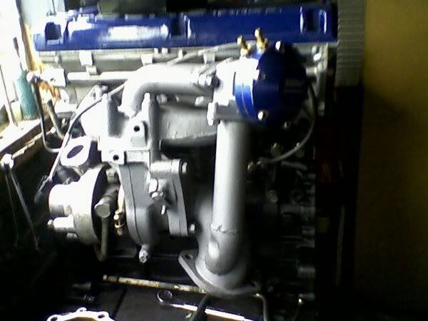

tsoob wrote:Here is the way we have mine setup
Thanks for getting the pic but I really can't make out what you've done. Im guess its a very short straight pipe going into the down pipe with no flexi and at a 90 degree angle?
If so, did you have any issue with boost spike or anything? I would have thought that having it at a 90 deg angle to the exhaust flow, it'd restict?

Postby tsoob » Tue Mar 04, 2008 7:12 pm
yes that is what is done it dumps straight into the exhaust ive had no probs with spike.

Postby loose_unit » Tue Mar 04, 2008 9:08 pm
Having it that close to the turbo, on that angle i reakon you would lose power. It would create alot of turbulence and kinda defeats the purpose of having an external gate, its pretty much doing a similar job to what the internal was doing.

Postby tsoob » Tue Mar 04, 2008 9:47 pm
no mate if the piping was going at a reverse angle ten it would create such a problem (turbluence) also an external is far more effiecient than a standard w/g and easier to setup/montior

Postby IH8TEC » Tue Mar 04, 2008 9:57 pm
it is still turbulent in there as it interfears with the exhaust coming out the turbine, it "should" be plumbed back in as far down as you can, i've read at least 18inchs or something, and at a good angle of entry, ie 45 or less.
