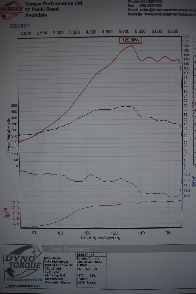

Postby method » Sun Aug 10, 2008 9:43 pm
Lets all LOL at this ugly graph.
AF is sweet at peak torque around 12. so long as its not leaner than 12.5 im happy.
Power dropps off, i assume ECU pulls timing then engine runs rich due to not fully combusting.

that dyno curve looks familiar, this is my car while running the 4agze ecu
Apparently a new knock sensor can fix this problem, however I recon go all out and get the proper after market ECU and have an 12 second evo killer :twisted:
also true to the colder plugs. I was running slightly colder plugs, dont remember heat range however they were also platniums. I should have given them to you but they were in the motor I just sold :roll: over $100 for good plugs

Postby mjrstar » Tue Aug 12, 2008 9:28 pm
I can't figure out why hp and torque are inversely preportional to boost, but i guess the ecu must be pulling some serious timing out of the equation.
I think my car is just running out of top end breathing ie cams valves etc..
it's a stock 1gge with singe turbo. i have put a 3'' exhaust on it since this was done so power may be up, i don't really know if the 2 1/2'' crush bent exhaust was holding it back or not.

Postby method » Tue Aug 12, 2008 10:43 pm
Ahh crap, must be the ECU thing then
I think the only reason its not dropping off as much as yours is because im running 15* advance on base timing. When i was running the 8 you could feel it drop off real bad.
PICS UPDATED DAILY
method
Posts: 1466
Postby MAGN1T » Tue Aug 12, 2008 11:35 pm
It's running way too rich.
Leaning it out, after dropping the boost and retarding the timing would make it go a bit better.
Or maybe I should rephrase that, Torque takes a dive at the same time the AFR goes too rich.
Maybe the ECU is picking up knock due to too much timing, then flooding it. Or maybe it's just running too rich and loosing power. It's always best to start with low boost and get it running right before increasing boost.

Postby method » Wed Aug 13, 2008 5:19 pm
MAGN1T wrote:It's running way too rich.
Steve
Ive now seen 4 different dyno plots with the same problem. Its clearly a ECU problem.
AF is fine, its 12.2 at max torque, it only goes crazy rich when the ecu takes the power away and by that time everything the ECU doing is $&#$%, not just AF ratio.
Will try playing around. may try ECU in diagnostics mode.

Postby ChaosAD » Wed Aug 13, 2008 7:21 pm
Its the map gze ecu. aparently the afm one doesnt have the problem.
Many theories as to what causes it and how to fix it. Some poeple say a new knock sensor, others a bigger i/c.
But an aftermarket ecu will definately fix the problem

Postby Caveman » Wed Aug 13, 2008 10:28 pm
Steve
You say in your sig after market computer is for people who dont know how to tune stock ones lol no tuning with this ECU, all you can do is make sure all sensors are 100% and even then it seems to be 50/50 running this style of setup. Or save yourself fuss, tune it properly with a programmable controller and get more power with more reliability.
The ECU is flooding the cylinder and pulling the timing, its trying to save the motor from what one can only presume is knock picked up from the knock sensor. On my plot you can clearly see the boost going through the roof when the timing is pulled as all the energy is going to the exhaust gas and the internal gate cant devert enough energy. Methods running an external so no boost problems for him.

Postby MAGN1T » Thu Aug 14, 2008 12:21 am
Caveman wrote:The ECU is flooding the cylinder and pulling the timing, its trying to save the motor from what one can only presume is knock picked up from the knock sensor. )
So you agree that water injection has a very good chance of fixing it?
Steve
Computers make you go mad.
MAGN1T
!USER HAS BEEN BANNED!
Posts: 646
Postby Caveman » Thu Aug 14, 2008 2:13 am
Steve
Not sure actually, I have done quite a bit of experimenting with a similar setup of mine and was directly involved in building methods setup and the thing that fixed my setup was relocating the knock sensor off the block. It was an extremely risky thing to do however in my lack of money I would try anything. As far as im aware the knock sensor needs noise or the car will go into limp so you cant have the knock sensor just hanging in space. Also it needs extremely good grounding or the car will go into limp. From this I hypothesized that the ECU is over reactive to engine noise and mistakes it as knock killing all the power. It could be a resonance phenomenon over 4ages as it appears to happen on bluetops, redtops and smallports at that specific RPM. I will not recommend this to method (but he'll try it anyway) as it completely removes any knock protection from the motor and is an engine failure waiting to happen. My motor running this setup was running 10.3:1 compression at 9psi. I used it for motorsport and it survived 100+ laps of pukekohe plus various hill climbs and other club sport without catastrophic failure, although after a year of abuse, increasing amounts of blue smoke became and issue for following cars... (probably more due to the constant high RPM than increased power output).
As you suggested, water injection will improve the efficiency of the motor by allowing a higher compression ratio (i.e. more boost) and decrease the thermal load on engine components however im not certain this will be a complete solution. Unfortunatly I feel it lyes in the ECU its self and unless someone has managed to interface and rewrite the standard ECU (not sure if this is possible for 4agze) then a replacement or at minimum a piggy back ECU is the only true solution.
However once youve swapped a supercharger for a turbo, changed both manifolds and even a new exhaust the fuel and ignition maps should be modified anyway, therefore after market seems like the only option.
One more thing ill suggest is ive heard of cases where a brand new knock sensor has cured the problem. Im hessitant to suggest this as a new knock sensor can be over $200, the source of this information was another car forum and an after market ECU would be fun to play with.
