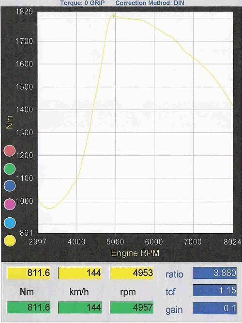

Haha here is a car which apparently gets full boost at 4000rpm yet the tell tale sign of boost building (torque curve going real steep) only just really starts at 4000rpm and finishes (full boost) just before 5000rpm. It may not sound like much but look at how short of torque you'd be at 4000rpm compared to 5000rpm if you had counted on the reported spool:
http://forums.toyspeed.org.nz/viewtopic.php?t=51671&postdays=0&postorder=asc&start=15
Its just an example, not a dig btw - its very very common as people don't like to call their own car laggy or whatever, its usual for talking up and it doesn't really mean too much but its really worth looking at dyno plots or if you can go in another car with a similar setup to gauge whether its really going to work for you. I reckon the T70 should be ok on a 3litre, nothing like a decent big motor which has torque anyway haha - though it will be interesting to see how it is to launch with the stock auto.
