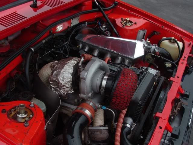

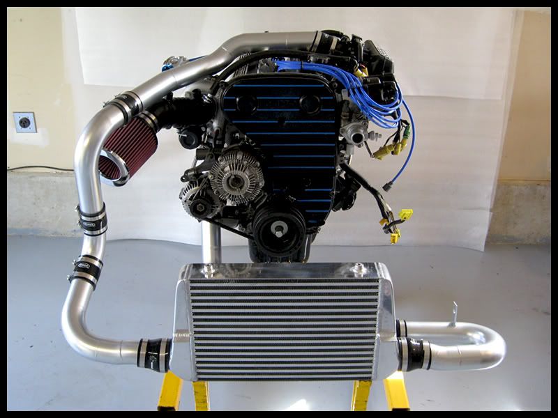

here are 2 pics of the set up ill probably be running with (most mk2 guys run their pipe work like this)
Postby deaf_rattle » Fri May 08, 2009 6:35 pm
as you can see, going front facing manifold will be alot of work.
Postby QikStarlie » Fri May 08, 2009 8:42 pm
looks like 2" piping in those pictures.
no gains to be had going to 3" piping with that throttle and manifold. 60mm throttle will flow less than a bit of 2.5" tube
it'l blow a head gasket either way :D

QikStarlie wrote:looks like 2" piping in those pictures.
definately 2.5"

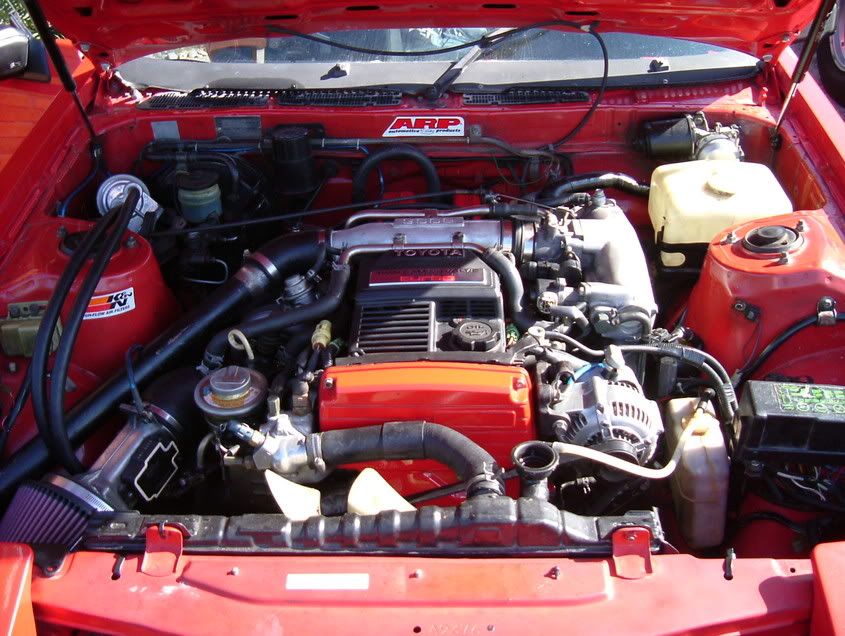

Postby mjrstar » Sat May 09, 2009 9:43 pm
i'd be less worried about going to 3'' pipe and more interested in making a foreward facing plenum to save about 2 metres of intercooler pipework...
not a 7m but the 1g in my starlet is along the same lines.

Postby deaf_rattle » Sun May 10, 2009 1:39 am
yeah, i have thought about it, but while running the stock ecu, i dont think the gains would be worth it.
you need to relocate the alternator for one.
maybe down the track ill look at that.

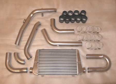

Postby docTRD » Mon May 11, 2009 10:43 pm
i rekn go 2.5" piping, if u can get a kit then even better will save a lot of hours labour making up all those custom bends. im going to be running 2.5" on my 1jzgte cressida as i don't want it laggy and going 3" will be more expensive and I wont be able to use a piping kit so yea it can get $$ going too big.

Postby deaf_rattle » Mon May 11, 2009 10:52 pm
the kits are $$$ and i already have the i/c, so yeah ill go with some custom plumbing. although id imagine it will turn out roughly like the kit anyway.
