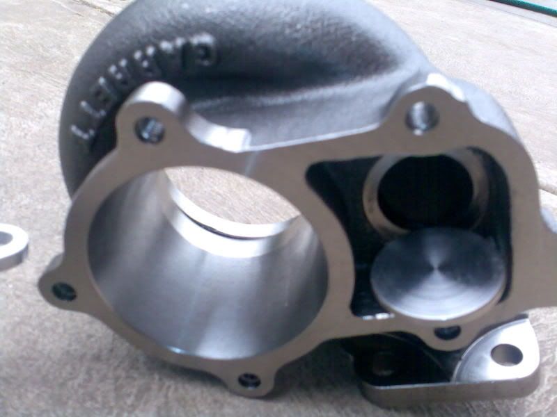

Here is the turbine housing I am using:

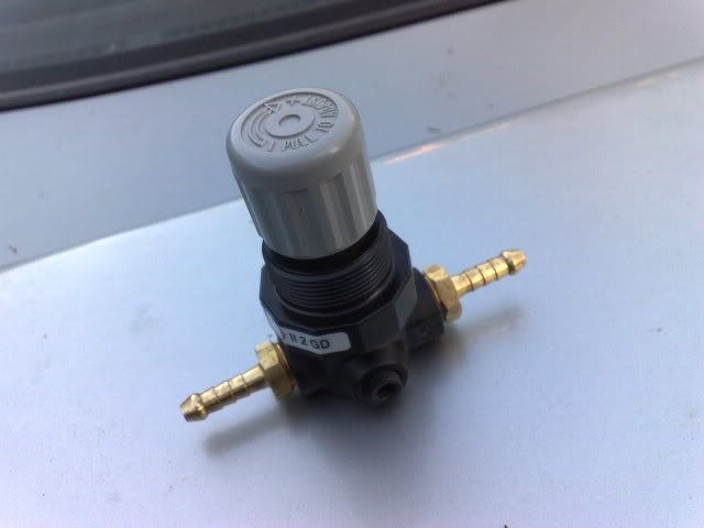

I had some fun during a gap in the weather today, so here is the new pressure relief valve I got from Norgren:

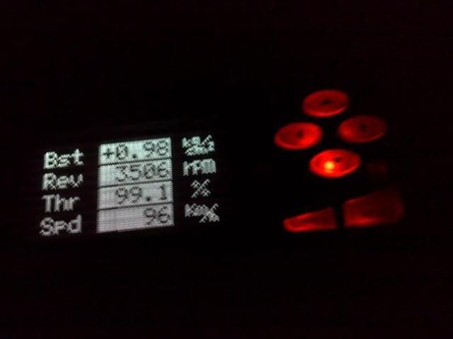

OK, put the original wastegate actuator back in - made a few adjustments to actuator preload, the pressure relief valve and the AVC-R and took it out for a thrash tonight and it seems much much much better.
1bar seems to kick in by 3500rpm, wavers slightly and is acceptably steady at around 1.1bar by 4000rpm which is where I would have been happy with it reaching full boost by anyway!
The bits for the Norgren relief valve cost me $70 and have really made quite a difference in terms of spool and response, quite pleased with the results of this hair brained idea.

I used one of the Norgren valves after having issues with the Link G1 boost control and I'd never go back! 8)
