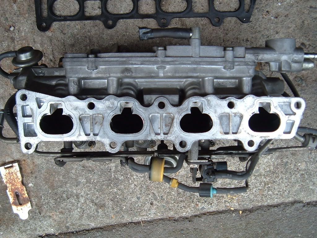

Postby Mr Revhead » Wed Aug 19, 2009 10:25 pm
Postby DXROLLA » Wed Aug 19, 2009 10:32 pm
Which ones are which? Can you tell what type you have without removing them?
DXROLLA
Posts: 557
Joined: Fri Sep 16, 2005 7:58 pm
Postby Mr Revhead » Wed Aug 19, 2009 10:48 pm
bottoms ones are the better
and unfortunately the only way to tell is to remove them
