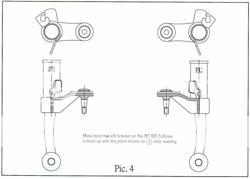

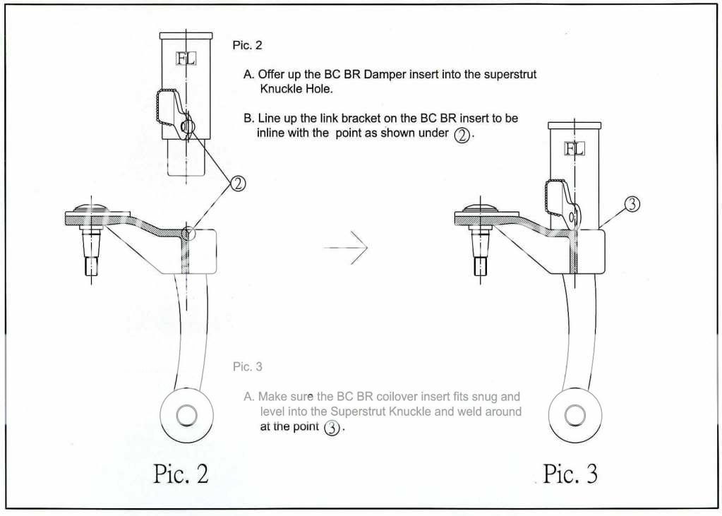

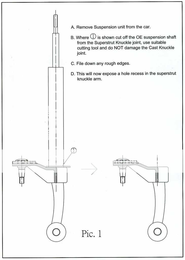

Just got some installation instructions, makes it easier to understand what they mean! here they are, thought some of you might be interested:
