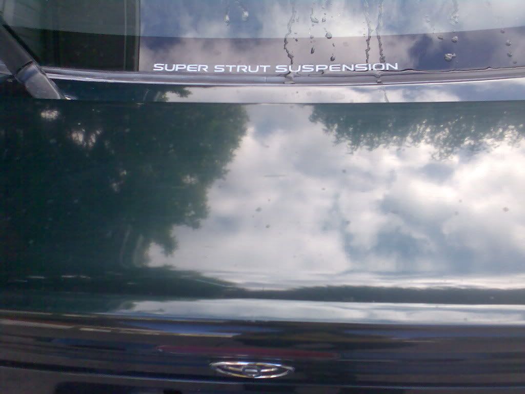

Postby gt4dude » Sun Apr 25, 2010 2:58 pm
Be ware of what you're actually getting, Not many people know much about NA Celicas.
A real SS-III can sometimes be difficult to differentiate from an SS-II, but some giveaways are -
SS-III always has "Superstrut Suspension" written on the bottom of the rear windshield.
SS-III chassis code is E-ST202-BLMZF
LSD comes with Superstrut equipped Celicas that have a Manual transmission ONLY. No other Celica comes with it. The Trans/Axle code is S54-06D
A redtop 3S-GE Beams motor doesn't neccessarily mean SS-III, It's a year thing, not a trim thing. Other cars including the MR2 G-Limited and the Celica SS-II also had the same motor from Late 1997 onwards, they did NOT come with LSD.
