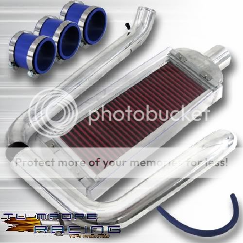

tim_blair wrote:i use an intercooler on a na setup
That is silly. It will not work. Unless you are spraying liquid that evaporates on the intercooler. The intercooler you have in there adds extra turbulence, drag/restriction, and perhaps heat soak.
If you are thinking about wind-chill factor - that only works if the object is hotter than ambient. In case of intercooler on NA, the air you are sucking in is the same temperature as air around the intercooler. It will not magically cool if you blow air on it. Thermodynamics 101, or shall I say common sense?

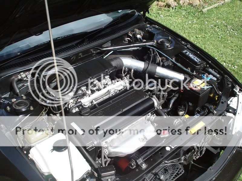

Postby RobertC » Tue Jun 22, 2010 4:39 pm
so pod in the guard will adversely effected the performance of the car?
My thinking was more cold air = more power..?
The only downfall I noticed after installing it was a slight decrease in response at low revs.
But this could be remedied by fitting an arc chamber like Acesnipers setup?
Or is stock ecu hindering any possible gains?

Postby 1I1 » Tue Jun 22, 2010 4:49 pm
It's more to do with the air having to be sucked through the intercooler core causing restriction

Postby Kittah » Tue Jun 22, 2010 5:39 pm
RobertC wrote:so pod in the guard will adversely effected the performance of the car?
Pod filter in the guard shouldn't adversely affect the performance of the car. That said, I don't expect it will benefit it greatly either.
As you pointed out, the distance has probably lost a small amount of throttle response, but this would definitely be remedied with an ARC intake chamber.
My understanding of why is that the ARC chamber acts as a reservoir for air coming in, much like I believe the factory airbox setup does, so that there is a readily-available pool of air to suck in.

Postby Snaps » Wed Jun 23, 2010 2:57 pm
I believe it's called an interfooler... :lol:
Seriously though, the air you're sucking through the pod is the same temperature as the air flowing through the intercooler, so it's not going to make any difference, the intercooler just becomes a restriction in the flow of air and actually makes you lose power.
