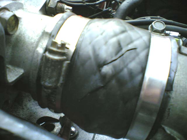

Okay, found my problem why I couldn't go past 0.64 bar and had a hasitation problem. The 2 slits are about 2cm long, it was hidden on the underside, didn't realise until I took off the pipings today. Toyota wants $115 for a replacement and ex Japan. Hmm okay.

Postby Dell'Orto » Tue May 03, 2005 2:33 pm
Just use silicon hose, be more readily available.
Postby Akane » Tue May 03, 2005 3:09 pm
It's a funny size. 70mm to 65mm
Postby Dell'Orto » Tue May 03, 2005 9:56 pm
3" to 2 1/2? there are reducers that do that

Postby Al » Tue May 03, 2005 10:55 pm
Mmm, Boost wrote:3" to 2 1/2? there are reducers that do that
3" = 76mm roughly.

Postby Akane » Thu May 05, 2005 4:06 am
I bought a 2.75" to 2.5" from TWSTD, and it fits like a glove.
