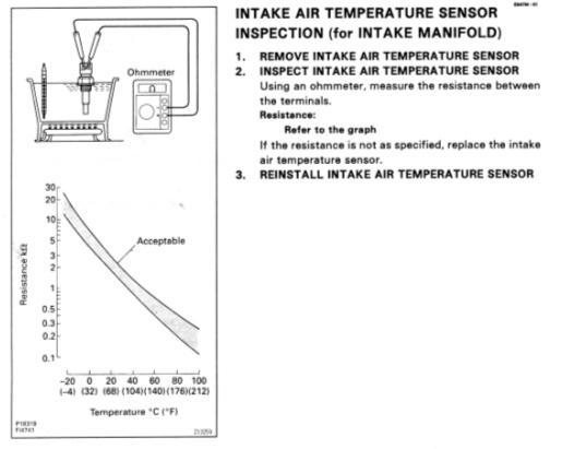

I am looking for the tempreture vs resistance graph for Gen 3 SW20 MR2 air intake tempreture sensor.
Part number: 89424-24010
Thank you.
Postby Wildcard » Wed May 18, 2005 9:13 am
Wildcard
Toyspeed Founder
Posts: 1966
Postby Akane » Wed May 18, 2005 5:00 pm
Sweet as! Thanks!
