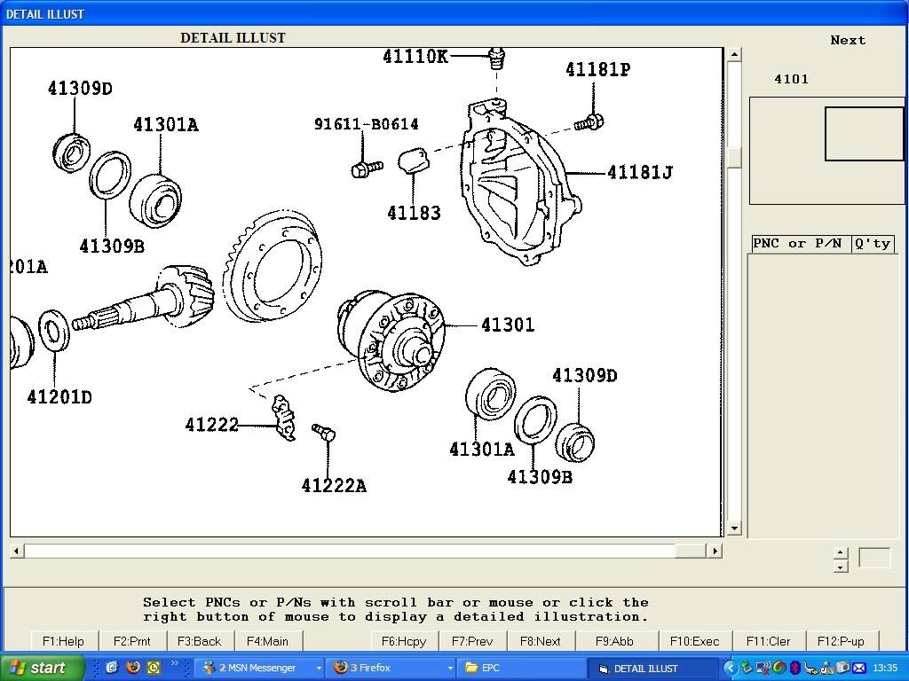

I think that's just the spider gears you're looking at, see attached parts diagram. As to whether or not it's a clutch pack diff, as the diagram doesn't show any clutch plates as parts I would think in unlikely.

But look at the parts diagram, what you see in the pic are spider gears, well at least that's where the spider gears should be if it's a Caldina LSD. The Caldina diff isn't helical(Torsen), as the worm/helical gears in a Torsen style diff replace the spider gears. Much more likely is that it's a viscous coupling.

it also dosent show any clutch plates
it also dosent have a second lock ring for a vicous setup
so imo of epc interpretation that is a open diff
though in saying that they also have a habbit of useing generised pictures and when it comes tim to look up the parts you discover that they are not what they look like

Postby Mr Revhead » Sun Jul 17, 2005 2:37 pm
that part number is listed for the stated vehicles from about 98 onwards, and the st246 caldina, not the 215.
the pic shown above from the EPC does look like an open one to me.
you cant always tell a viscous from a helical on the EPC, but my guess is its a helical type. viscous diffs are sealed units afaik.
if any one is looking at that pic on the epc, hit the "next" button, and youll get some like this:
Postby fivebob » Sun Jul 17, 2005 3:08 pm
Thanks for clearing that up Warwick. According to Toyotas webpage the diff is Torsen.
It also appears that the diagram I posted is probably for an open diff :oops: seems that the ST215W autos were indeed an open diff, only the manuals were LSD. Strange as the auto car I dissambled appeared to have a LSD and apart from the mag wheels had no modifications. Must go back and check to see if it really is LSD or is stuffed from the side impact it received in the crash :evil:
BTW only ST246 GTFOUR-N models are LSD, mental note to self, only buy an N model
