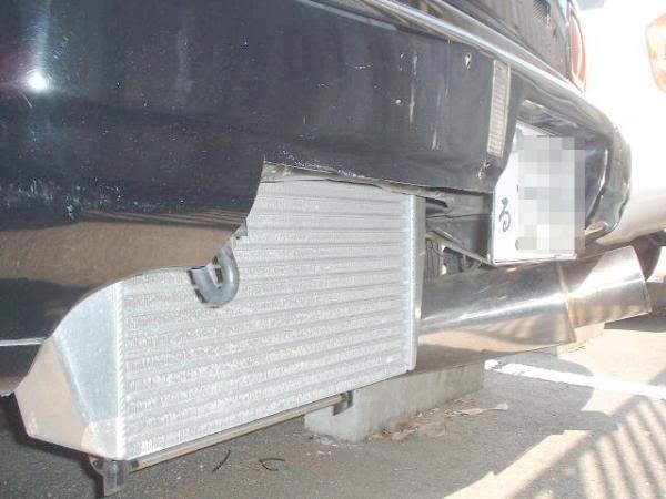

Postby anthonym » Tue Aug 09, 2005 8:43 pm
All_Fours wrote:Man, you really take it personally when someone suggests something that you don't agree with...
Nah only when someone casts aspersions on his favorite windmill. Been there done that, still waiting for the pudding. In the meantime here's a pretty picture of one of those big fans fivebob likes so much :D.

Postby samlloyd » Tue Aug 09, 2005 9:18 pm
back mount ic looks like a good idea. Apart from scraping on the drive going into pak'n'save
