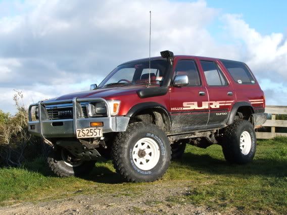

Postby NEMESIS » Wed Aug 10, 2005 12:00 am
strx7 wrote:What model is your surf? 130 series? any mods? :lol:
1990 Hilux Surf fitted with a Lexus/Soarer V8 :lol:
Suspension Lift (EFS), 50mm body lift,33x12.50x15's
And thanks again dudes!!....awesome help...fantastic... :D
