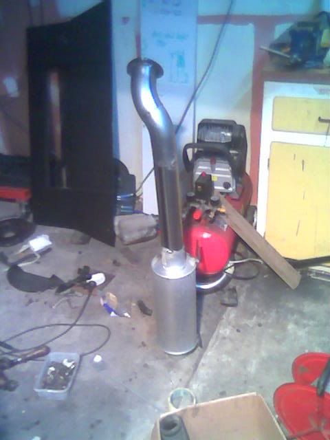

Well it looks like I'll have the old extremely wicked+harcoredownpipe from my gt4 that I sold to my mate back to borrow for the drags (yay), and whilst that pipe is on my car I'll see if I can improve on the XS power one. I'm thinking I might cut a section off a bend and attach it over the top of the current wastegate route to provide a path for the air to go through.

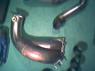

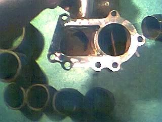

As above, mmm, boosts car had the same prob. Here is the pipe I built for it...
http://photobucket.com/albums/y248/BBBrad/?start=20
Had to take it back off and do some minor mods to the wastgate section, kind of made it slightly more aero-dynamic, and all is good now. The wastegate flap was checked for full movement and to make sure it wasnt hitting anywhere in side the wastegate chamber.
It seems to me even with its quite large flap and outlet holes the ct20b seems to be quite vonerable to this unable to flow at the top end. Just about all of the pipes on the market seem to be of the shared main outlet/wastegate area type, similar to the factory setup. I can see why though, its a tight squeeze in there, with the oil filter in the factory position and aircon still on. But in the end its all good with a proper divorced wasgate system.

here's the old downpipe me and a friend made that was on my gt4 (the one I am going to borrow off my mate to see if it'll work)
